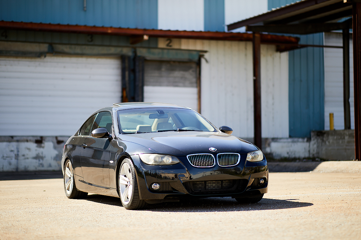

Style 313's
Love my Style 313 18 in rims....
